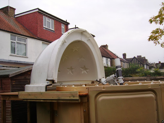

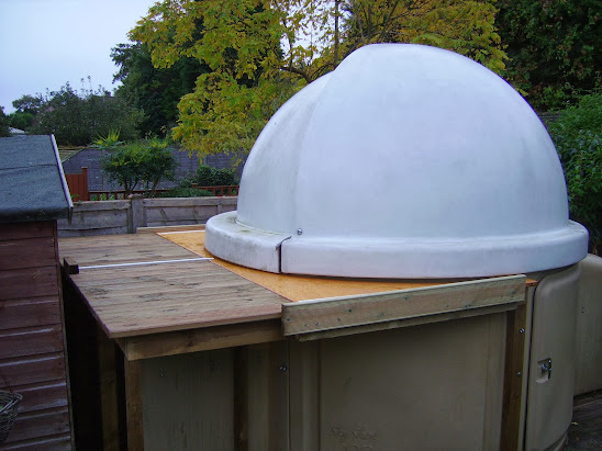

The POD Zenith table is virtually finished.  Just a few tweaks, but it works. and enables me to reach the Zenith. Just need to fit a couple of ramps to make getting the domes on/off at the sides a bit easier.  There are 3 strips of slippery plastic fitted onto the table for the dome to slide on (and not wear out the varnish).
The dome slid back by about 2'6"/3'.  As you can see the dome is still in the way towards the NE, but I never image over that way anyway, partly because the houses are in the way and lack of objects to image in that direction. Objects mostly rise from behind that loft extension, so I'll be able to see the objects right through until they set or disappear behind a tree in the West.  The dome can also be swivelled slightly on the table.
Need to practice getting it on and off a few times before I dare try it in the dark.
