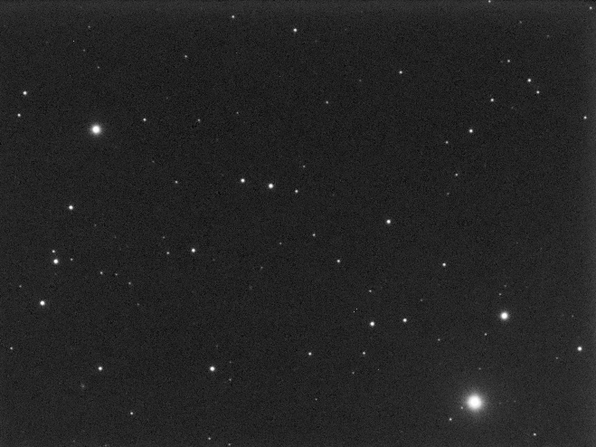

Well I have finally got to bottom of my guiding (drift) issues. As you all probably know I have issues where although guiding works fine but I get shift between the subs. I had tried everything to eliminate the problem which although didn't really effect images too much the stars were marginally mis-shaped which obviously means I must also be loosing detail in what I am imaging. Some of the things I tried were different telescopes, different mount methods (ontop V's side-by-side), all the different guide progs going, polar alignment, drift alignment, guide rings & probably other things as well.

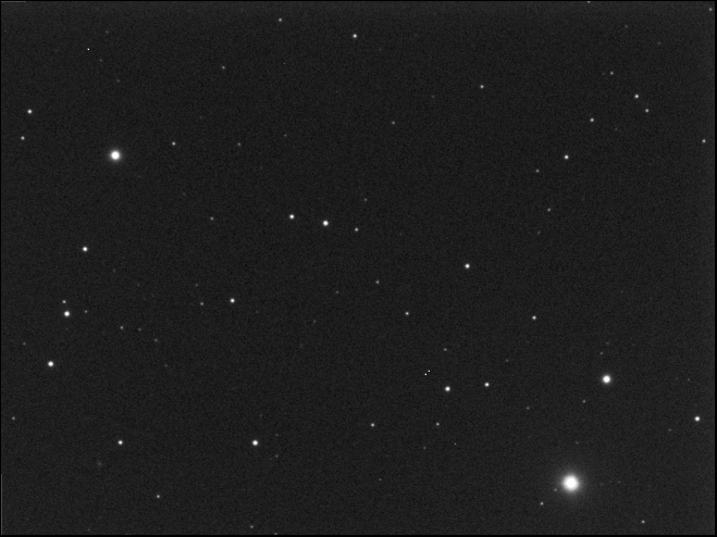

Well last night I borrowed Jim's (thanks mate) OFF AXIS GUIDER. I attached to ED80 with my imaging camera. I had only ED80 on my mount. I did a very quick polar alignment (didn't bother with drift or anything) & then set up focus on the OAG (a little tricky at first but not too bad). I then pointed at a random area of sky calibrated my guide prog (Guidemaster) & off I went. I did 4x5mins & 3x10mins. I couldn't believe difference every sub downloaded right ontop of previous (no drift) & had perfectly round stars. Below are stacks of the 7 images I took (50mins total). The first stack I have aligned the individual subs with 2-star alignment & the second is with no alignment at all - I just stacked the subs one on top of each other. If I had done this previously with my setup I would have had horrible eggshaped stars.

Sounds like the problem may have been flexure then.
What is the OAG model you used?
Yep definitely even though I had what I thought was a rock solid setup something was still moving. I even eliminated the mirrors by trying different scopes for guiding - It really did my head in. Anyway if last night wasn't a fluke then the OAG is definitely the way to go. The one I borrowed off Jim is the BrightStar one from Bern - He is selling them for £94 - You need something like 30mm of back focus to insert it but no probs for ED80 (might be for reflectors).
John
I think a lot of trouble is with the focuser, even the Moonlite's have some movement though I wouldn't have expected that much with a light camera like your's.  Anyway, whatever the cause, the results speak for themselves.
