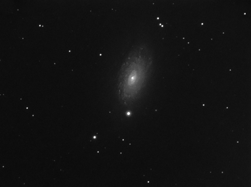

Popped out on Monday night for a few hours primarily to do a guiding test. I have had issues with drift for the last couple of years that has been really bugging me. Basically, my guiding all works OK but the whole image tends to drift in a certain direction so when I look at first & last sub of a set there might be as much as 10-15 pixel shift over a 2hr session. This isn't a big problem but as I only image with a 640x480 sensor it does tend to make stars mis-shapen which pee's me off...!!! Anyway, I have tried everything to fix problem including different scopes, mounting method, rings, guide progs.. Anyway on Monday I decided to give drift alignment a go. So I downloaded WCS for webcam & gave it a go. Seemed to do the job really well & although my altitude (up/down) polar alignment was pretty much spot on my East/West (azimuth) adjust was off & took a few iterations to adjust. I always just used polar scope & whilst I get close I think the problem was my scope was still having to make corrections in Dec when guiding which has been causing me probs.
Anyway after adjust tried following image for quick test. 15x300secs (crap skies) - CLS filter - ED80+Atik16ic. Although, I still did get some drift it was a lot less than normal & the thing I am impressed with is stars are really round :-) I think with a few more practices it'll only take me another 15mins or so to do the drift align so I will start to make it part of my standard setup as worth it to get nice round stars. By the way I also used Guidemaster software for guiding. It worked faultlessly, was a breeze to setup & works great with my modified webcam (much better than PHD does)..
Cheers,  John.
Greg
Just spotted your image on the forum. Why is there a bright 'star' at the galactic centre. You haven't captured a supernova have you?
Hi Greg... I wish  :) I think it's just the core of the galaxy maybe stretched a little too far - Cheers,  John
