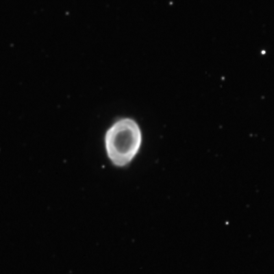

Yet another M13! The setup is the same with 34 of 38 subs stacked, 6x300s + 32 x 120s (EQMOD crashed doing the 300s subs).
The major difference is a 5mm T spacer between the Baader SCT to T mount unit and the Canon adaptor. And lo, there were round stars! (maybe no quite round enough for you perfecionists!). The remaining mis-shappeness I think is now just guiding jumps and jitters as described.
Thanks to Mick and Chris for the EQMOD Rate setting - not 0.2 use 0.5! Makes calibration of PHD a lot quicker too.

Here is the same crop as before:
Wow Dunc - looks tons better - nice one. Bet you are feeling chuffed with that - John. :-)
Fay
Great Duncan, I am going to reprocess mine now, as it does not look too good!!!!!!
It is healthier to be mutton dressed as lamb, than mutton dressed as mutton!
Duncan,
That's much better!  Those stars have a much better shape now.
That's definitely the best one.  The core is showing more detail and the stars are nice and round.
